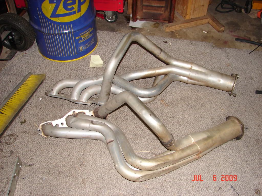

                    Here are a few more pictures of what the Hookers look like:

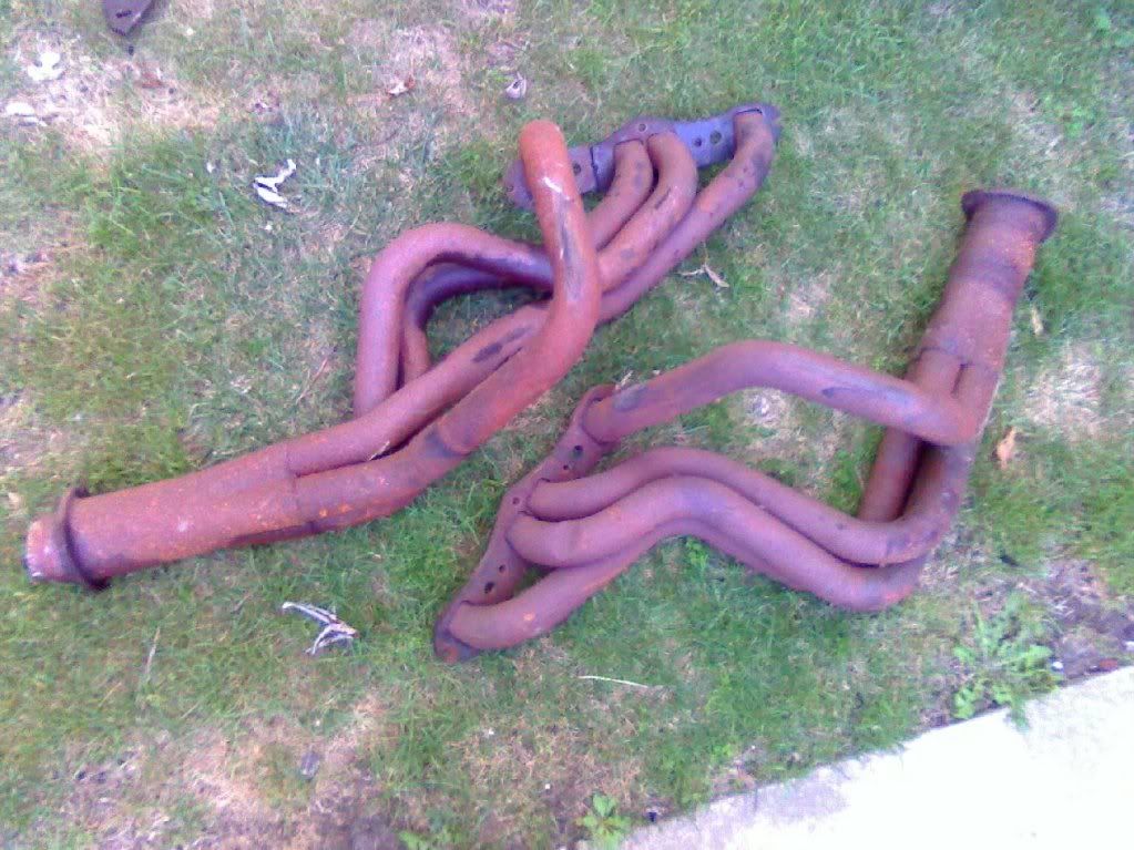

                    Here are some of mine before I coated them, bought them used for $190:
                      a little more research done, it looks like the DMR headers are just as much as the Hookers If the DMR headers are inside the frame then thats whats gonna be ordered...
