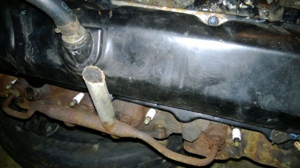

    I am going to have to replace or repair the AIR tube that leads from the valve nearest the firewall on the right side down to the converter. I see a few options, one getting the complete tube, another is getting a repair kit. Here's a link for what it looks like, if your not familiar with it. If you are, is it worth the trouble, or would you recommend another solution?

    I'd just replace the tube, its easier than removing and plugging eveything.
    Also the AIR system injects air into the exhaust ports to ease startup which means the O2 sensor might be affected but Im not 100% since the O2 sensor might not provide mixture feedback until its warmed up and in a closed loop. It also injects air into the CAT to aid in the catalyst reaction during warm operation.
    I know my 85 442 is missing the AIR setup and has rich startups but I believe the choke is suspect... who knows with these cars though, theyre very sensitive to emissions control.

      Yep, that's what I'll do. I found one at Rockauto...think this will work:
      They have another one there that is AC Delco, but I don't think it's the right one...tried cross-referencing it and came up with a Buick part. Fun part about this will be getting it in place...removing the old one was no fun

            Engine is out, and the cleanup/rebuild is starting. Looking at the AIR setup, I wonder if I would have trouble with ECM codes if I bypassed (jumped the terminals) at the plug for the electric switching valve, eliminating the AIR altogether. If I ever went with a different engine, say a 403, I would not have the AIR setup, so I would have to bypass that anyway if I used the CCC. I'm just not sure how it would run with the switch bypassed.

              The check engine light will not come on if the AIR system is not hooked up.
              At least its not coming o in my '85 442.
                Both tubes are badly rusted...I'll have to replace both. The tubes run from $20-$37. Not sure if it is worth putting the money into them.
                May just plug the holes and see how it does.

                  It all depends on the level of restoration you are going for, if you are going to be just driving the car I would just plug them.
                    I do intend to drive the car, and take it to car shows and cruise in's. I intend to have some fun with it (might even consider a bigger engine if the 307 doesn't have enough power). I can always put the tubes back on if I need to get it back to original. For now, I just anxious to get the 307 done and everything put back together so I can drive it.
