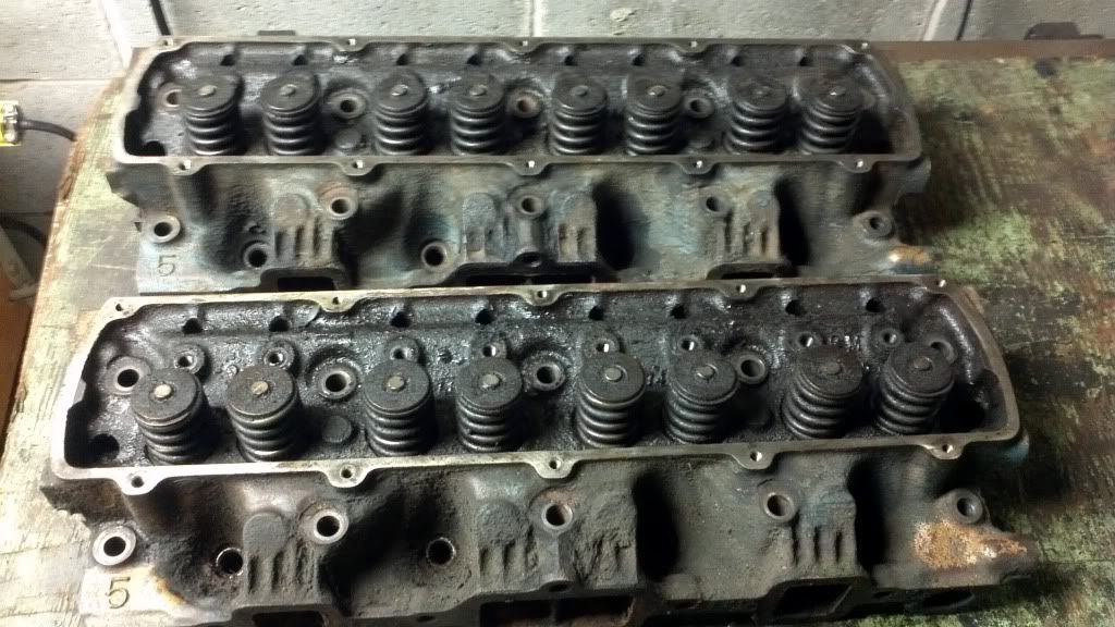

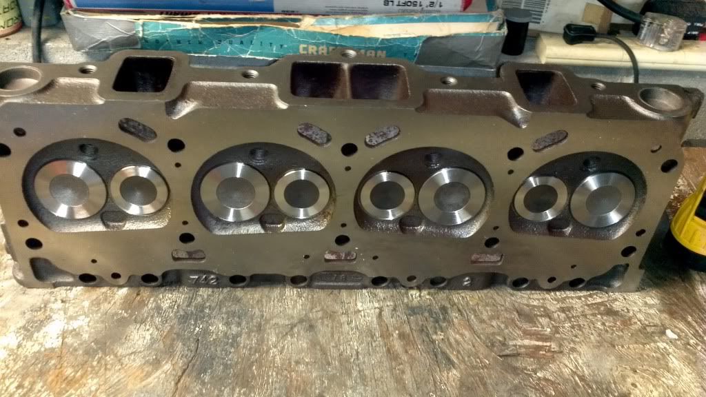

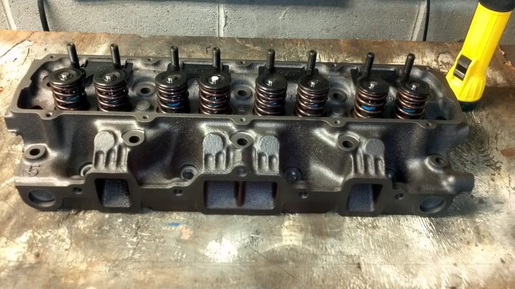

                His shop is about an hour from my house. I had him build my #5 heads on the 350 and build my 383 stroker sbc (he does more than Olds stuff). He showed me around the shop and really worked with me on what parts to use for my builds. There are closer shops but I won't go anywhere else.
                Before:
                After:
