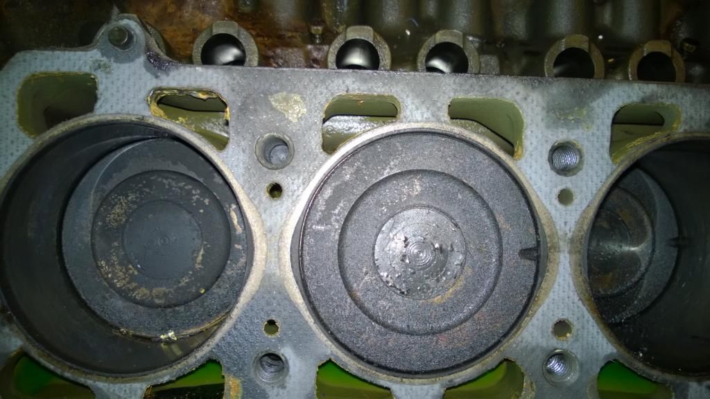

      I was going to finish checking the rest of the 307 (which is not as dirty as the 350, btw). I stumbled on something that made me stop. I read where the 307 VIN 9 was supposed to have a piston that had a horseshoe-shaped dish in it...that's not what was in mine. Here's the pic:
      What kind of piston is this? Could it be that a dealer swapped in a VIN Y block? I'm going to pull the cam to check the number, but it is looking to me like they may have used the VIN 9 parts with a VIN Y block...I think they were in a hurry to get it back together. The cam does have the button and spring on it. I'll find out if the cam is right in a day or two when I get back to it.

        VIN9 pistons are the same as VINY and do not have a horseshoe shape to them.
        The only difference between VINY and VIN9 are the balancer, exhaust manifolds, carb and valvetrain (cam/springs).
        I would just replace the rings, bearings and seals, find a pair of used heads that are still in good shape and run it if you are just looking to get the car to a driving state and put as little money into it as possible and save your money for finding a good running 350/403 to rebuild in the future.
          Thanks for the help, it's much appreciated. Wonder why the aftermarket pistons all show a horseshoe shaped dish? That is really good news, because I did not want to swap out pistons right now. I'll look for a set of heads that have some good valves, and swap out the springs. As for the 350/403, I have the one 350 that could be rebuilt, but I'm kinda leaning toward finding a 403 at some point. As for the 350 in the 77, I didn't want to get into pulling that right now...I have a really bad feeling about loosening those manifold bolts. I broke two off on the other 350 when I was pulling the manifolds...both in the center of the head It's going to take a bigger torch than I have to heat them enough to get them out...it's either that, or drill them out and retap the threads.
          I'll let you know what I find out on the cam when I pull it out.

            I heard that the aftermarket 307 pistons are wrong and actually have a shorter pin height I believe which means they sit further in the hole and the block needs to be decked just to get back to the stock CR.
              Well, I know they certainly don't look like what I had. Even 442.com says they have the horseshoe-shaped dish...not sure where they get that info. At least the ones I have will give the correct CR. I'll stick with these.

                  Hmm, I could be wrong on the horseshoe design but my '85 442 engine has a circular dish.
                  The information on 442.com points to roller motors with 6A/7A heads and the horseshoe design promoted port velocity for the swirl port design for fuel economy.
                  I just know that there wasn't a difference between Y and 9.
                  Sounds like you have an aftermarket rebuild, does the VIN match the car?
                    Unfortunately, there is no VIN stamped on the block that I can see. It does have a block number that corresponds to an 87 block, "6509GM5.0L G". Found the code in the Mondello book. Could it have been a replacement block that wound up at the rebuilders, and then bored out? I'm going to go visit the original owner once the car is running. He only lives about two miles from me. I've got a lot of questions, and would like to show him how the car is coming along.
                    As far as the VIN numbers on the rest of the car, all numbers, from the VIN #'s written on the paperwork with the owners manual to the SPID match. Just wish it had been stamped on the block. It still looks like they used a different short block with the original heads, since the heads were black, and the block had no paint at all. I wish I knew how to decipher the tag on the side of the block.
                    As far as the pistons go, I'll have to go with what I have...not much money to spare. At least they look ok...the underside and skirts look clean. I think they'll work ok. If I need more power, I can rebuild the 350 that is sitting in front of the car right now...maybe in a year or two.

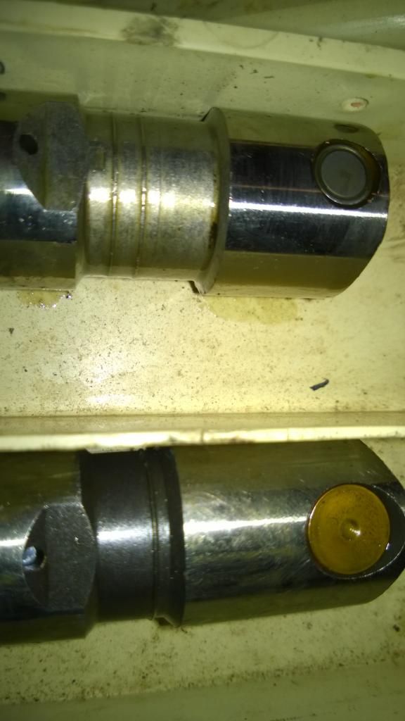

                      Need some help figuring something out. One of the lifters is slightly different than the rest.
                      The top lifter was in the intake valve spot on the #1 cylinder, the other one in the exhaust, same cylinder. All the remaining lifters look like the one on the bottom. The diameter and length is the same (sizes are to spec for the roller lifter), but I couldn't figure out why they looked different, until tonight. I ordered a new lifter to replace the top one, and got one exactly like it. Started looking at the lifters again, and realized that the oil bands were different. Why would one have a larger oil band than the other one? Would this cause a difference in the way the engine ran?
                      Is this a problem that needs to be addressed? It seems like there would be a difference in pressure, given the size of the oil bands.
                      Also, does it make any difference whether the oil hole points toward the front or rear of the bore? These had the holes pointing toward the front. Just want to get it right.
                      I'm going to also post on realoldspower...got to get a solution soon, as I am currently cleaning up parts, and will be assembling the engine very soon.

                        Just saw this and the responses there.
                        GM did some improvements to the design of internals over the years and the fit/function are the same but looks like they may have improved on oiling.
                        The engine probably had a collapsed lifter at one point and was replaced.
                        Why they just didn't replace all of them is beyond me...
