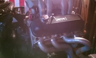

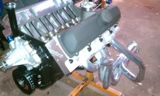

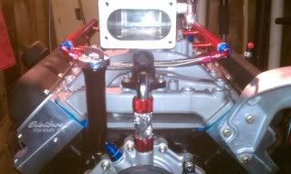

    I finally got around to start assembling my 455. So I figured I would start a build thread I hope to have the engine in the Olds by the end of the winter and have the car running by spring to make the 2012 season . I will update this thread as I make progess on the build.
    Some details about the engine are 72 455 from a Delta 88. The block is .30 with speed pro forged pistons 10.1.1.The rotating assembly has been balanced. I am using a Mondello roller cam with the following specs duration 280/274 Lift .523/.512 with lobe seperation of 114. A set of edelbrock heads and roller rockers from Mondello as well. I will be using the fuel injection from my 502. I hope to get 480 -500 horse out of this combo. Some more pics

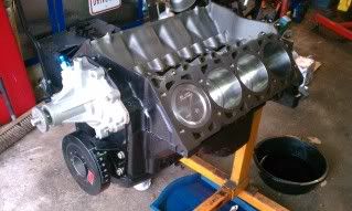

            update from 2/19/12

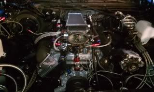

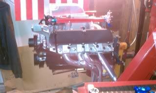

            I used my day off to get some more work done. The 455 has a new home. I got some new pics to post.

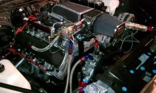

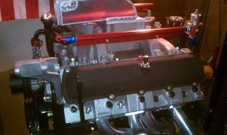

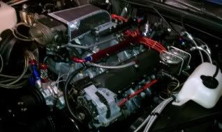

                    2/26/12 Spent a couple of hours today working on the Olds. All my fuel and computer connections are done . I am hoping to have her running in a couple weeks . A few pictures I took today

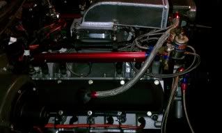

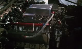

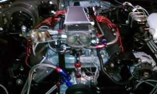

                        3/14/12 made some more progress. Just have to get the belts and connect the exhaust .

                              I like that tuned port throttle body you made work on that setup. I would be willing to bet that you will be upgrading to a large monoblade throttle body by the time you're done tuning it. That big block olds is gonna want more air. Looks like a nice configuration. Keep up the good work!
