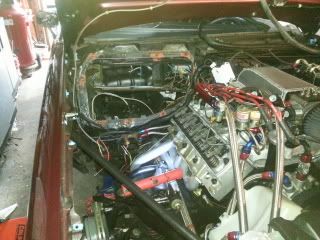

    [QUOTE=88hurstolds;2794]What kind of intake are you running on this setup?
    Sorry it took so long to reply. I was in Bermuda for the week
    http://www.professional-products.com/fuelrails.php This where I got my intake from. I was going to have one custom made but the price got out of control!

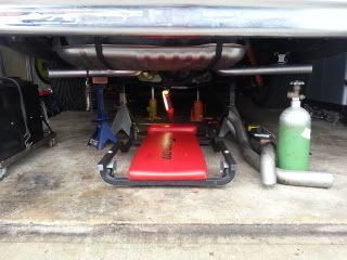

      I haven't wrenched on the cutlass in a while.This project is something I have wanted to do since I put the 455 in and return the cutlass to it's Oldsmobile heritage. I have been playing with the exhaust and changed the mufflers and tailpipes to the 442 style and get rid of the monte carlo style. You can see the old pipes on the floor. I ran out of Argon for the Mig welder when I get more I will post more pics.

        Nice, I like that style better than the Monte style.
        Seeing pipes running along the bottom of the quarter out to the bumper looks tacky, especially if you can see a clamp.
        Are you going to cut an angle into the tips like factory?
        The top one is Walker, the back one is factory.
        • #34
          Thanks for the picture. I had the angle on the tailpipes but wasen't happy with the way it looked. I cut the pipes flush. If I change my mind I could always cut an angle again. I do prefer the original cut.

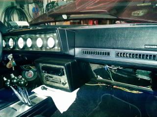

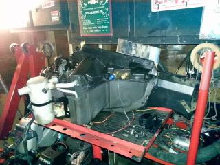

            Took advantage of the nice Sunday weather to start my winter project. I am tired of sweeting so over the winter I will installing A/C so next car show season will be a nice and comfortable one.
            Removed the dash to install the duct work and A/C vents
            A/C box restored and ready for install

                    I made more progress today. All the old heat stuff is gutted . Now started on reassembly

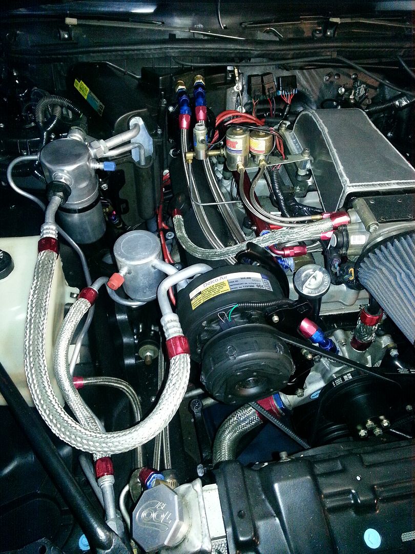

                      made some more progress. Got the dash installed and the A/C box installed with a new evaporator. Next modify small block compressor brackets for my big block and get the rest of the parts. The will have to wait till after the holidays ( The money will be going to buy Christmas gifts)
                      • #41

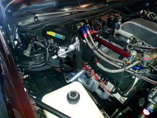

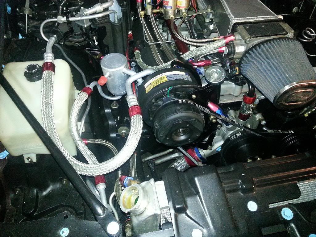

                        I was back at it today. I got the compressor mounted and wired. Just waiting for the proper dryer to and ALT belt to arrive. A picture to share the progress

                            • #44
