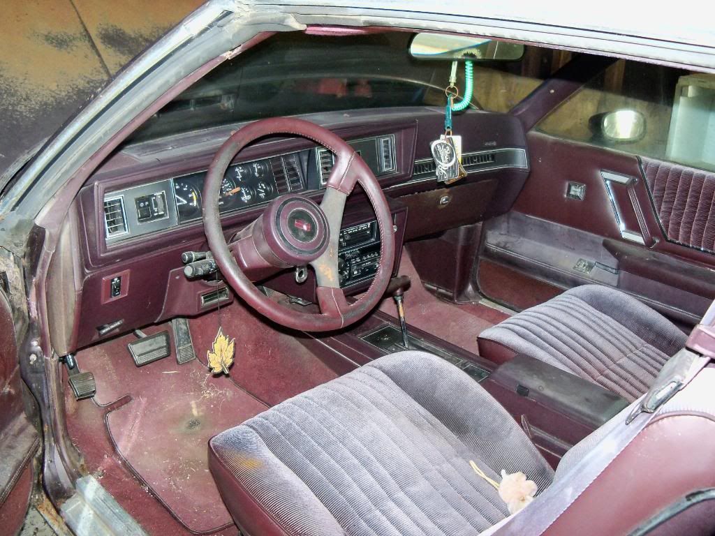

    Interior shot...kinda dirty and faded (used flash when I shouldn't have).

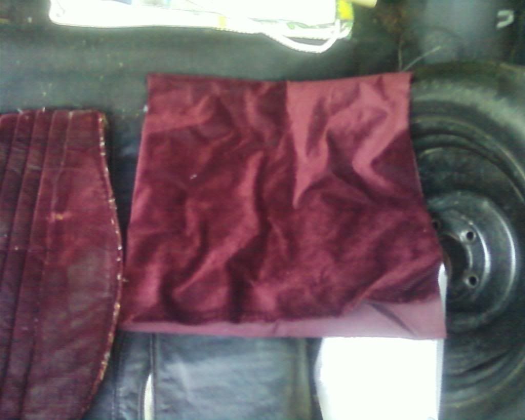

    I was amazed that the interior was still in good shape, with only some fading from the sunlight. When I opened the trunk, I found a large section of cloth for the interior...the matching upholstery, brand new:
    Yes, that is a t-top bag underneath...don't think they were used much.
