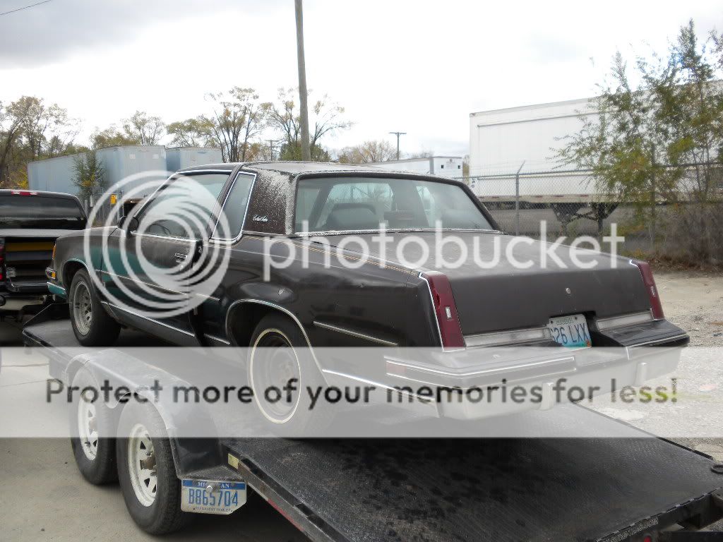

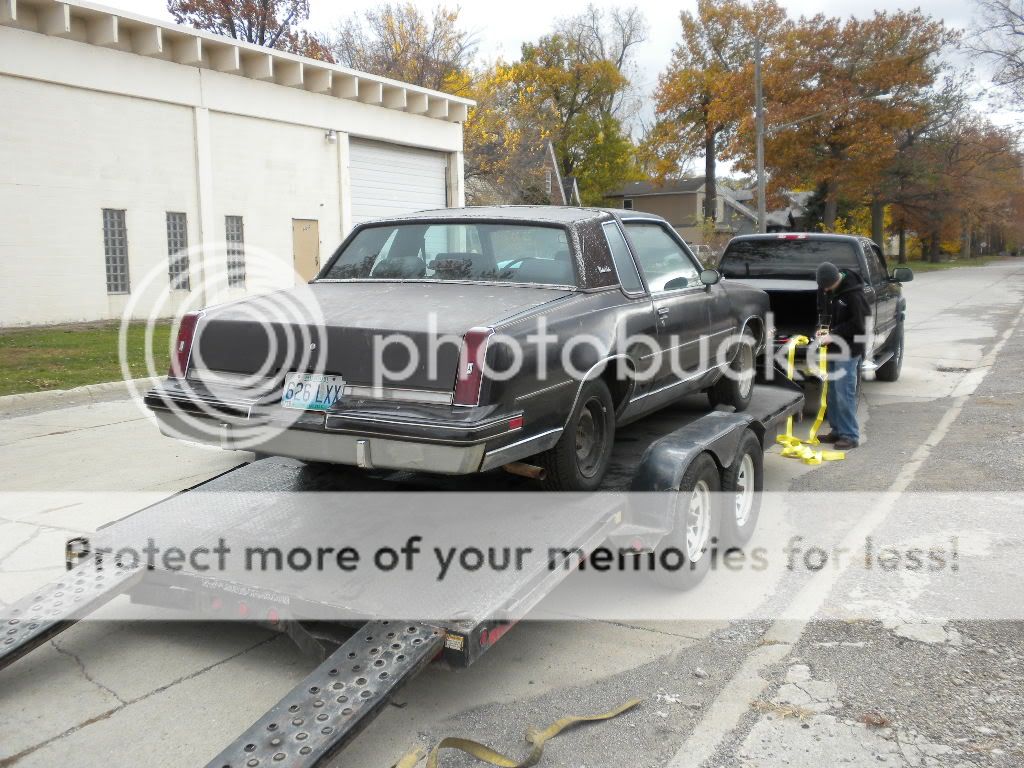

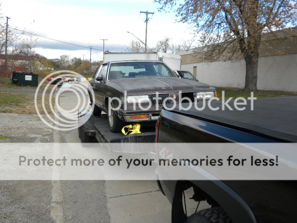

    So after a lot of work on my original hard top I realized I would never be happy without t tops, so I bought a donor.
      Well, the t tops leaked, so the floor was trashed.
