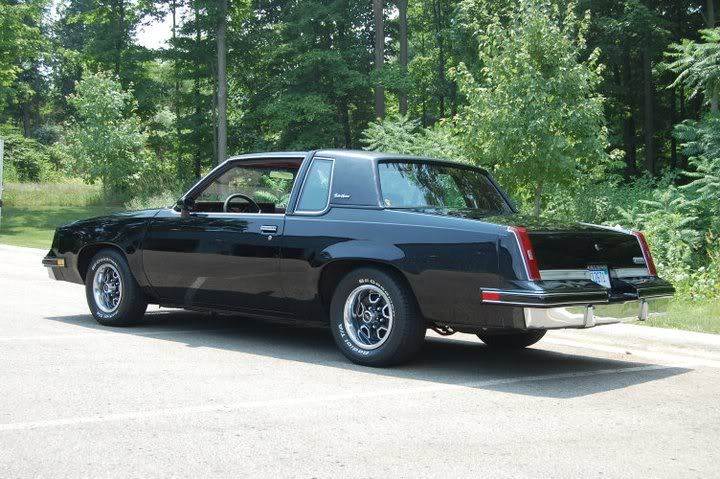

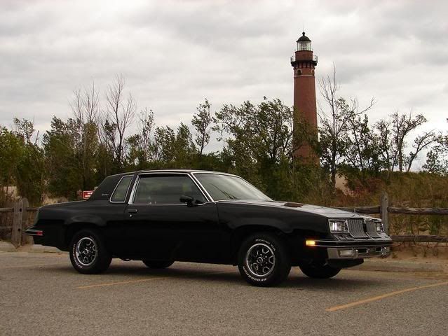

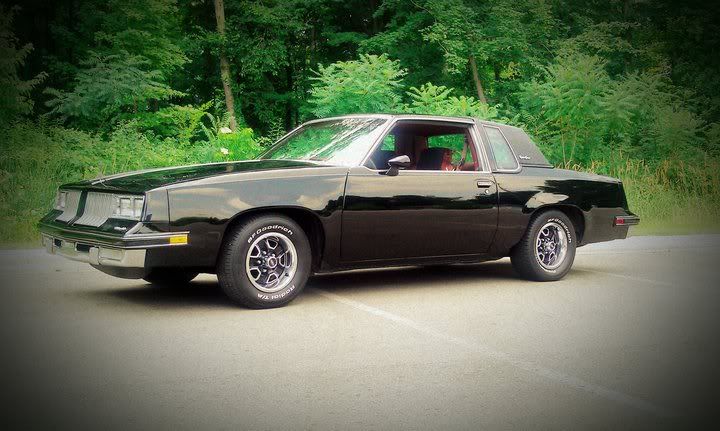

    wanted to say hello from kzoo Michigan...Im a owner of a 1984 Cutlass. Car has been in the family since new. I did a full restore about 5 years ago now. always doing something to it.

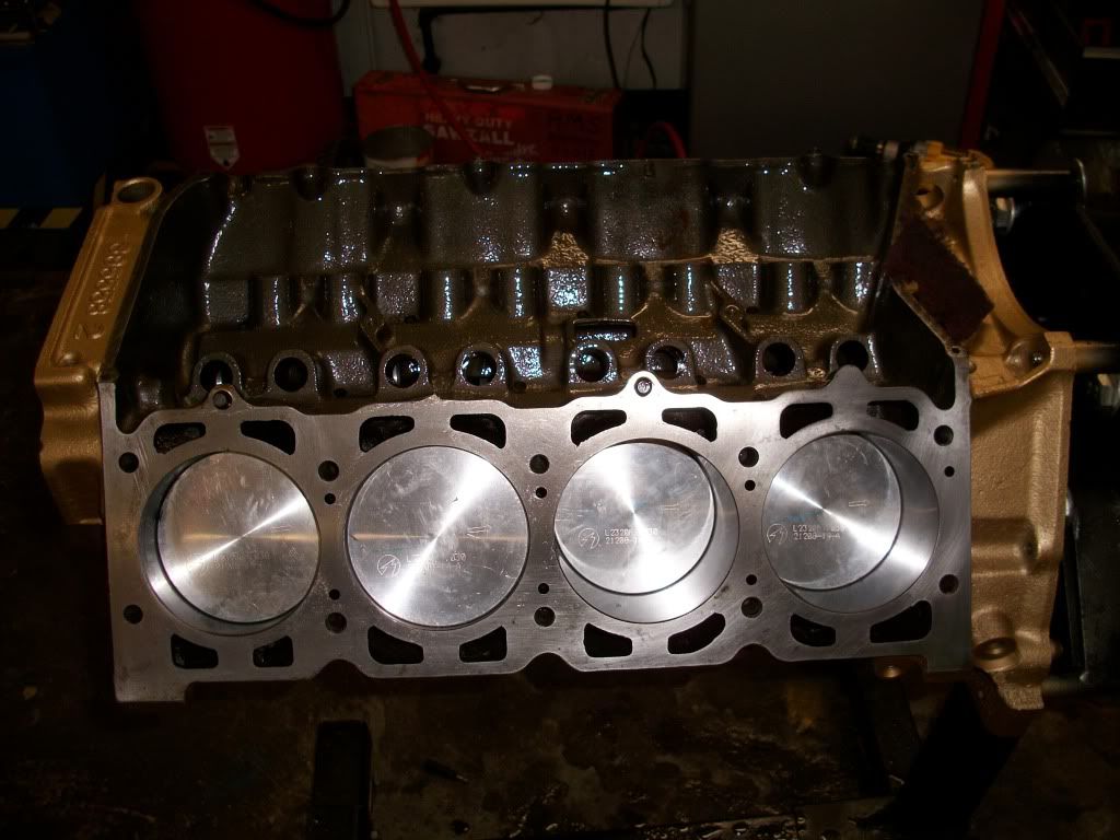

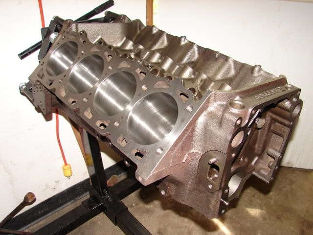

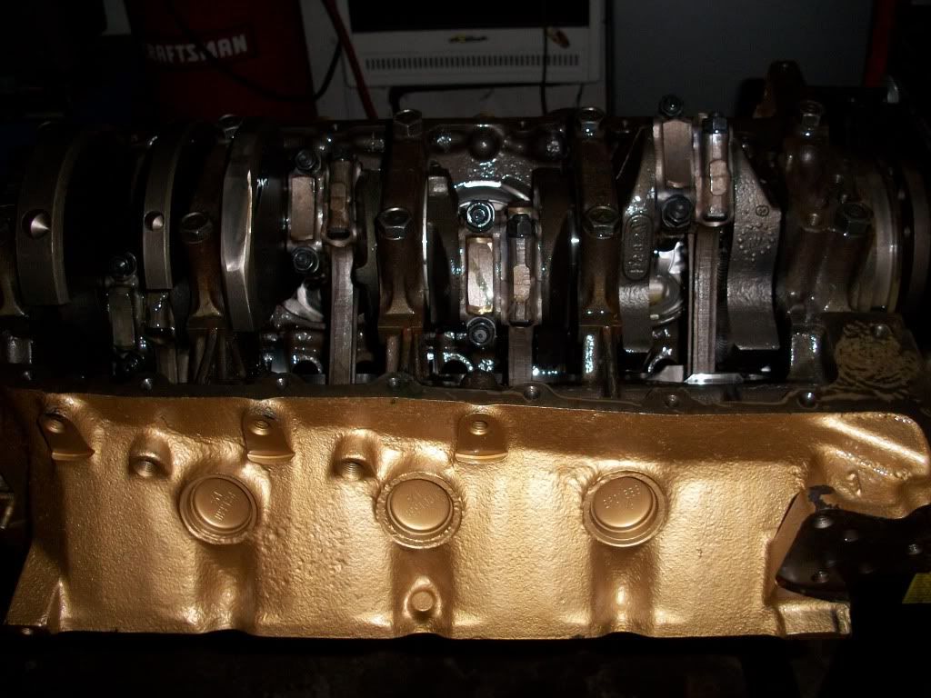

    im in the process of building a 1970 W30 Olds 350 right now. All machining is done by Dowker Engines. #5 heads port and polish, .30 flat top speed pros, N-crank, Voodoo valve train.
      Thats one hot ride!
      I assume you meant W-31 350 since W-30s were 455's.
      Any port work being done?
      Is the cam to W-31 specs?
        Yes the heads have been ported, polished by Dowker Engines. They were decked, came out to be 62cc's. 2.070 Intake valves, 1.62 exhaust I believe...
        The came is a Luniti 60803 .510 .522
